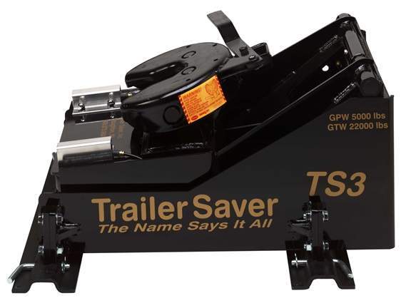

  • Mine is stashed away for the winter, but this photo gives you a pretty good idea
