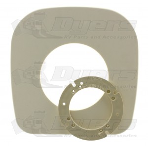

My Sealand 210 toilet has been a PIA since new. The water/flush mechanism gets stiff and the ball valve won't close all the way. This Sealand is bolted to the flange with two bolts/nuts and two lag bolts into the floor near the rear of the toilet. I bought a new Thetford 310 which we liked but it needs an adaptor to fit my 4" flange. Anyone installed a replacement? What kind of adapter do I need? Wonder why my MS has a 4" to 3" flange??

    Maybe what you want? I am not sure if this is what you are looking for or not.
    My new toilet ia a "Thetford" 310 ReVolution. Got if from Camping World and Thetford is all over the box. Regardless, it is made for a 3" flange and mine id 4". It leaked like a sieve.
    I am not correct. The new toilet was a Dometic 310 not Thetford. I stand corrected. Sorry.
