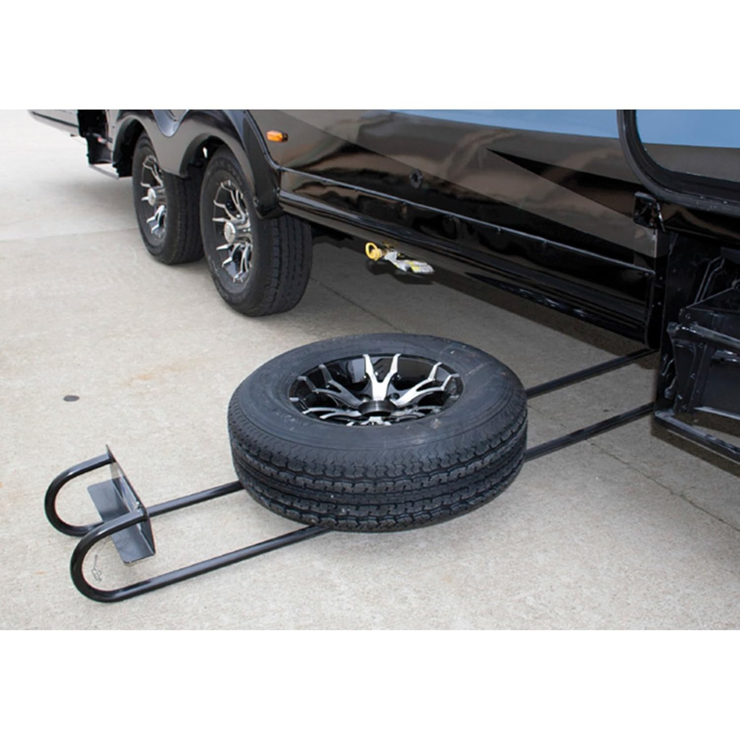

  • I didn't want an undermount but fear I may have to go that route
    I don't believe that I would be able to bolt a mount through the door without significant reinforcement. By the time I did the fabrication and work it will be a lot simpler to spend $100 for the Bal spare tire carrier.
  • Do not mount it on the ramp door. After seeing a ww ramp door all apart, imo, without disassembling/modifying ramp door its impossible to secure it correctly to the inner door frame.
    Get 1 of these, or something similar...
    jmo
    https://www.amazon.com/BAL-28218-Hide-Spare-Storage/dp/B00KPQYV0E
