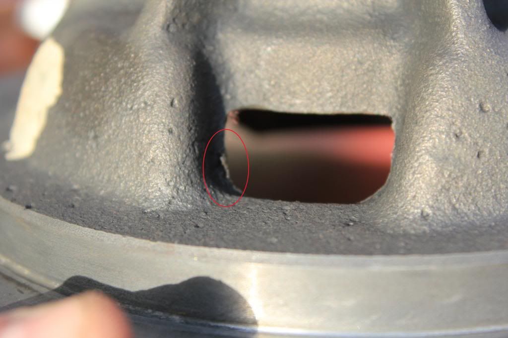

After draining diff fluid, I found some large shavings on the magnet. I feel compelled to remove the entire differential for closer inspection. So far I can see nothing obvious like a disintegrated bearing cage, but it is all but impossible to see the differential gears. I measured backlash at .009 and looked at gear mesh using ring/pinion paint; see photos. Based on gear mesh patterns the coast side looks to be a little too high on the ring gear. I'm certainly no expert reading these patterns, so input welcome. I do have some reference material. The drive side looks okay to me.
