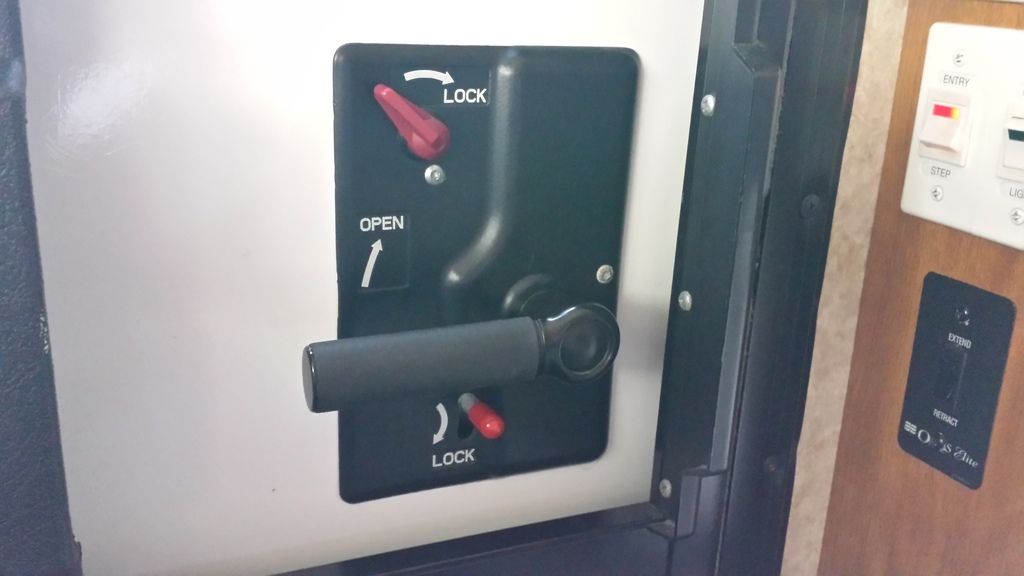

We started having issues with the entry lockset where when we try to enter and we pull on the handle, it pulls but does not open the door. When that happens, we can open it from the inside with no problems. I took the lockset apart and looked at the mechanics on how that works and what I found was the interior door 'knob' which when pulled up is what does all the mechanics of opening the door (latch). The outside pull handle simply has a piece that pulls the interior door handle up and thus opens the latch. I think, possibly, what is happening is there is some slop in the mecahincals in the door which allows the exterior handle component to pull too far and actually on top of the piece that it is supposed to pull thus NOT opening the door.
I know this is a lot of rambling but if anyone has any thoughts on my issue, please advise. I am at the point where I believe I need a replacement lockset.
This is the style I have:

  • My Handle did that on my Pace Arrow so I took it apart and seen that the the metal ear or prong was starting to miss where it was supposed to hit so it took just a little tapping to bend it so it would make better contact.It was last year so I can quite remember with out seeing it apart again but know it was an easy simple fix
  • Mine did the same thing took it apart everything fine what I found out it was slipping because the whole thing was moving it would not work so I tighten it up and still happened ended up using a little caulking to hold it in place works great now
