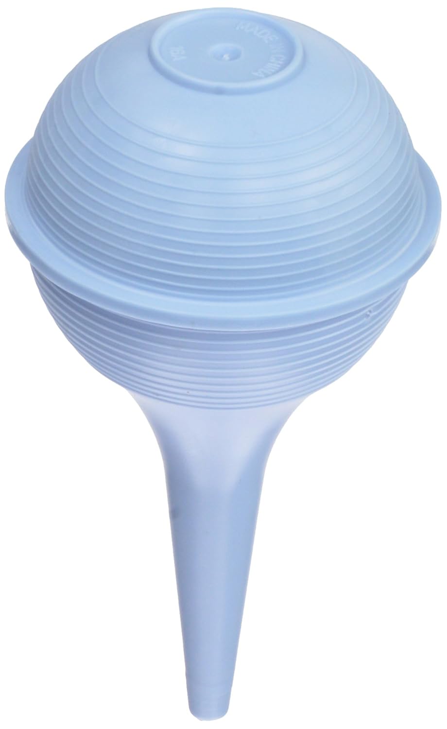

    My batteries are in the open, so I don't need a mirror, but I use an ear syringe to fill them. Holds about 2 ounces.
