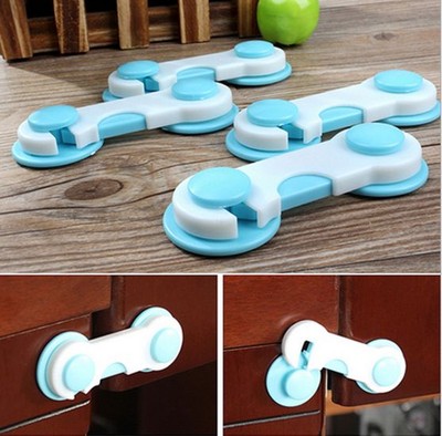

- IvylogExplorer IIII found them on eBay under child safety locks... I liked this style the best of all the ones I saw The cheapest came from China so several weeks to be shipped. I'm sure you could find them from a US reseller for a little more and quicker shipping. I like to have spare items so I bought the five pack and painted three of them black.
- GGCIIIExplorerIvylog
I'm almost finished with my new fridge. Where did you get the latches on the doors? They should work well. Thanks for your help. - IvylogExplorer IIIThis refer is not a counter depth unit so it sticks out more than the NOCold... 6" plus the handles. It's the same amount as the hallway behind it so not a big deal, so to speak.

Bought these to hold the doors shut when traveling but may have to paint them black for the DW... guess she earned it helping to get it in.:B
Had some black plastic paint so I installed the door locks. Need one fitting to hookup the ice maker and that should complete this project.
