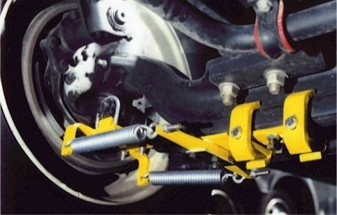

  • Can you help us by identifying which bolt is backing out. Here's a picture of a typical installation.
    If all else fails, you can remove both steer safe units and complete your trip.
    Fred
