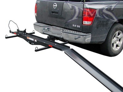

  • Ivylog's avatar
    Ivylog
    Explorer III
    I would go with something like this but I would extend and attatch the two tie-down bars to the MH.
