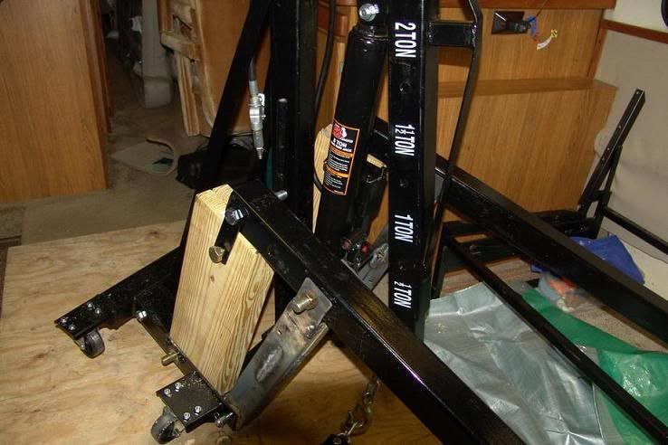

    Below is a photo of the modification to the engine hoist, so the legs would go up over the raised area over the engine.
    One other important note about the engine hoist. It has an air to raise it up. That made a huge difference as I was working in a very confined space. It also allowed me to lift the engine, without being at the back of the hoist. I could move the engine around while lifting. I bought it from Pep Boys on sale for 100 bucks. Have no idea what they go for now.
