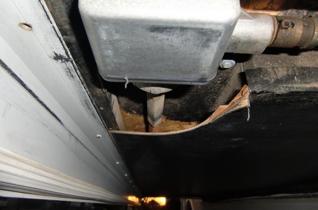

  • Probably not exactly the same-see the roll pin in the upper right?
    pkunk wrote:
    Get under and look for a busted sheer pin. I have a pic of mine somewhere.....
  • Get under and look for a busted sheer pin. I have a pic of mine somewhere.....
