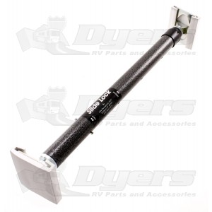

    Before all the fancy motor gear locks the RV's used a SLIDE LOCK BAR between the inside of the slide and the inside wall close to the ceiling inside the trailer.
    Looked something like this:
    photos from google search
    You might be able to rig up a couple of 2X4's laying on top of the slide that is inside the trailer when pulled-in to do the same thing while trying to figure out the problem with the motor gear lock...
