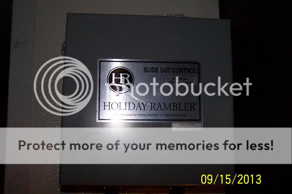

My signature HR has a single slide out (LR & Kit. driver side). Occasionally, I have an issue with the engine start up, that is, there is a safety circuit that if it senses the slide is out, will not allow the engine start circuit to complete. BTW, the slide is not out, in fact it is in and travel clamps are in place when this occurs. Does anyone know whether this is a limit switch that needs adjustment and where its located? Or is the in/out position stop strictly a motor torque sensor and is it adjustable? Luckily, there is an override switch that I can depress that allows the start circuit to work, so I've never been stranded, but I would like to adjust this issue away, if I can.

  • Good pic. Can you take a pic of the inside controls? Does that cover come off? Doug

    I'll try again since the basic question is still; does anyone know what is the normal method for detecting the position of the slide-out especially the IN position. From what I have already described, there is obviously a lock-out in play here that prevents starting when the control perceives a condition of slide out. Again, the slide is not out, in fact, it is in and manual locks are in place. I want to troubleshoot this issue and would like a place to start. I have opened the slide-out control box. Some relays, integrated circuit components, etc. I don't see any obvious adjustment pots. The control was made for HR by Todd Engineering, but a quick internet search shows no commercial product they sell for RV slide-outs. If nothing turns up here, I may try to contact them and see if anybody has a clue.
    THAT was my point in my post. I have 34 years as a RV Tech (Master Certified) and have worked on and FIXED hundreds and hundreds of slide out systems on almost all makes. I cannot remember when I had a slide system that caused the Chassis engine to not start because of some so-called safety interlock. There may be such a OEM system, but I have never seen it. If Monaco cannot help you, then you will be hard pressed to find anyone to help you. Can you take a pic of that Todd Engineering module? Todd was known for Transfer Boxes and Power Converters in the RV industry and never about slide controls. The Newmar RV's use a magnetic switch on the rack/pinion to detect when the room is closed or open and this is just for the Automatic electric lock arms and not about engine control. Doug
