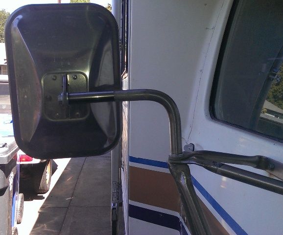

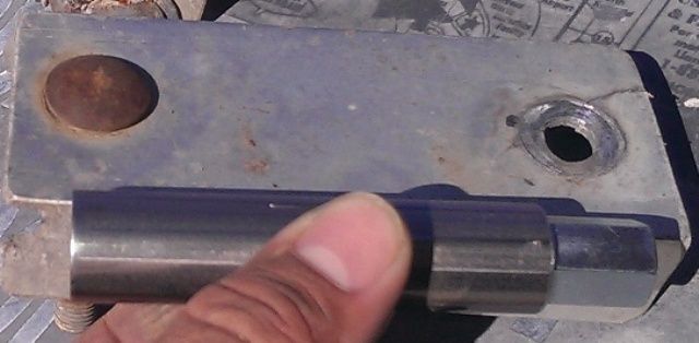

When I bought my RV the mirror's had been butchered and someone added a "home made" side mirror extension that consisted of a piece of aluminum u-channel.
The aluminum u-channel flopping around on the mounts is a crappy extender, but I didn't want to spend on a new set of extended mirrors since mine are still intact. I decided to make my own extenders.
The supplies I needed were as follows.
3/8 X 1 1/2" bolt
3/8 X 4" bolt
3/8" threaded rod coupler
3/8" metal (X12) and nylon (X8) washers
3/4" steel plain tube

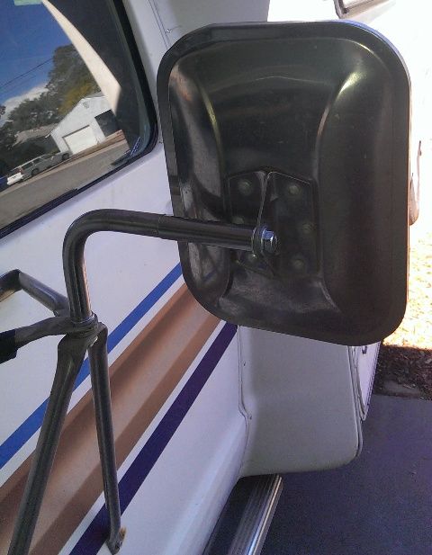

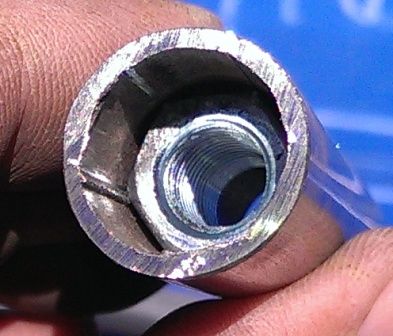

Once I removed all the******that was on there, I cut two small pieces of the 3/4" tube as long as the previous extenders (3-1/4").
Then I pounded the threaded rod coupler down into the tube.
Once the extender was ready, it was just a matter of bolting everything on. At the base I put on a metal/nylon/metal washer stack on the short bolt and then passed it up through the holes. On top, I put another stack of washers and threaded on the base. On the mirror side, I grabbed the bolt and slipped on metal/nylon washers, then the mirror, then another stack of washers. After that I just threaded the long bolt through the coupler inside the pipe and threaded the whole thing onto the end of the original mirror support arm.
The original arm is solid stainless steel, so I have no fear about the extra leverage of putting the mirror further out. It looks great, works great took on hour to do and cost less than $20 in parts. I might paint the metal tubing silver just so it doesn't stand out or rust.
Hope this gives others ideas of how to extend their mirrors.
Jose
