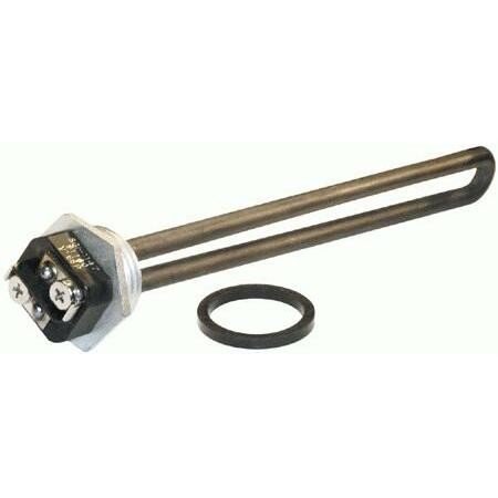

  • I would try to determine where the leak is without disturbing the tank itself. It is possible the leak is where the 110v electric heating element is screwed in. It could be the rubber seal there that needs to be replaced. Or possible the heating element itself. If so, it would be much cheaper than replacing the tank.
    Here is a typical 110v heating element.
