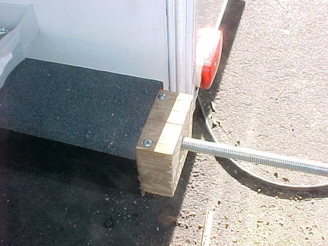

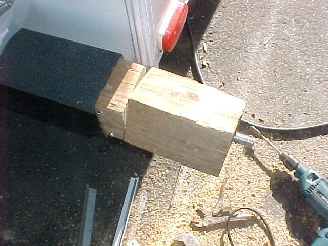

1. 4x4 with screws added for snug fit to bumper. Hole drilled through center. Recessed hole for nut and washer.
2. 4x4 (SHORT) to hold antenna base.

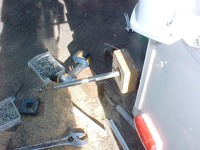

3. Bolt tightened to secure 3/4" all thread from moving.

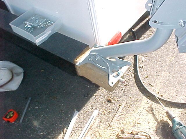

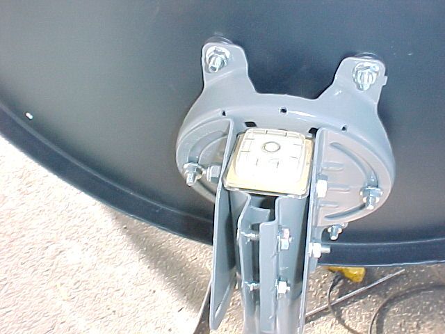

4. Dish base added (I am lacking one nut to secure it tight--Hdwr store monday.)
When tight and in place and PLUMB I will secure level.
Now I can adjust left and right with the antenna base and Fore and Aft with the 3/4" end nut. That will tighten the short 4x4 against the 4x4 inserted in either side of the rear bumper.
