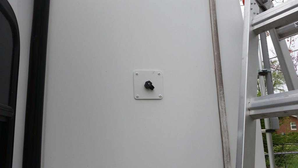

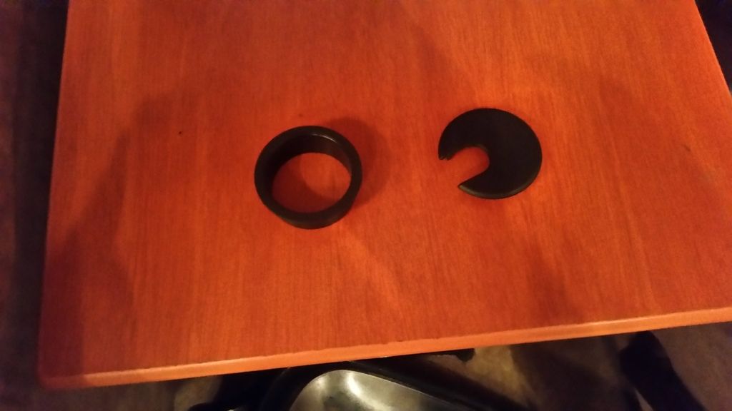

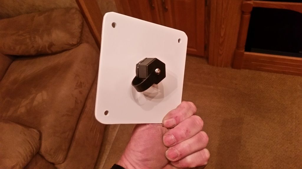

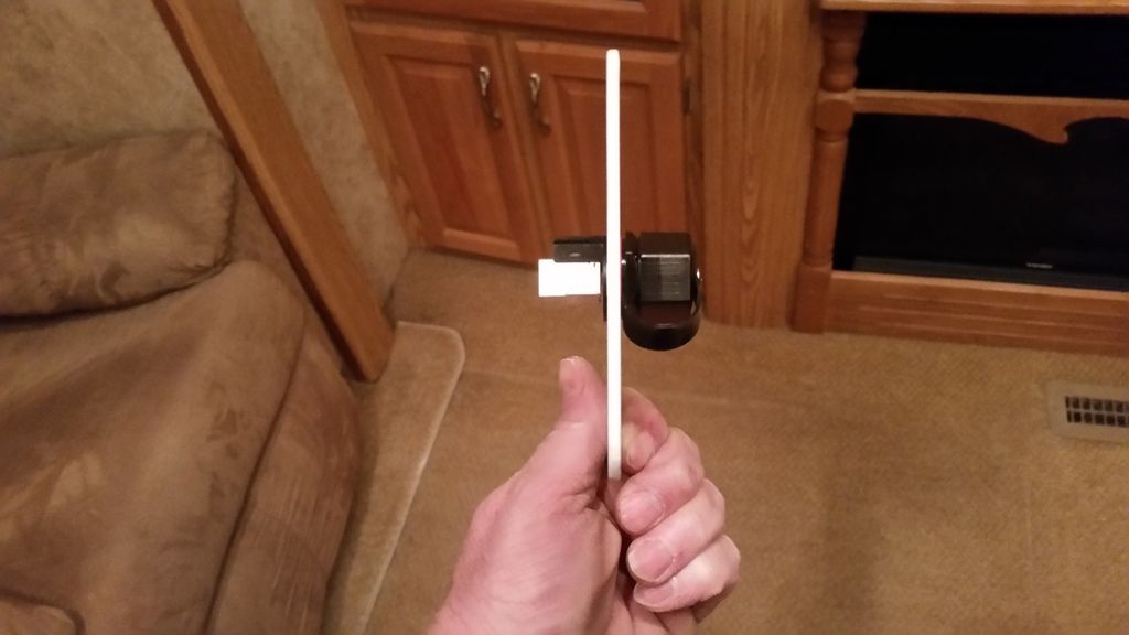

Hi all,
I use a ubiquiti nanostation as a wifi repeater in my 5th wheel. I have the nanostation mounted on a piece of 1" PVC conduit so I can remove it for travel. Long story short, I want to put an ethernet jack as a passthrough on the side of the 5th wheel. The interior cat5 cable that runs to my router will be permanetly connected to the inside of the passthrough. The outside connector is where I will connect the cat5 that runs to the ubiquiti when in use then sealed when not in use. I am looking at getting the following and was wondering if anyone had a better solution for an weathertight ethernet passthrough that can be sealed.
Passthrough
Cap
Connector
The only concern I have with the above parts is the thickness of my sidewalls.
Steve
