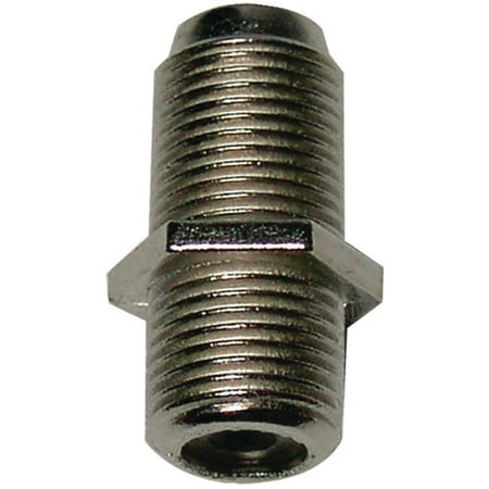

    Not real sure how an Omni works, but the signal is amplified at the booster. Nothing feeds back to the antenna. It's like a vacuum sweeper. The motor is sucking the air into a hose. The booster is sucking the signal into the wire (boosting it). Any "power" needed (if it uses any) should go through the coax cable, same as a Satallite Dish - like the Tailgater for DishTV.) There is a coax connection at the antenna on your camper. simply unscrew it and use the connector, above, and run longer length to your new antenna.

    Here is what I suggest. Set up your pole outside your camper. Attach the antenna. Run the coax from the antenna to the coax attached to the Omni. Use a joiner (double end threaded connector) to join both wires together, and then use your television inside the camper as normal. You can still flip on the booster or turn the booster off. I suspect, if you turn the booster on, you'll get many more available stations.

    When you say "joiner" are you talking about a splitter? Two inputs on one end-omni plus residential, and one output to stock camper coax?
    If so, how does power go from switch by TV to the omni? Isn't it through the coax? Or is it a seperate wire from switched amp to omni booster?
