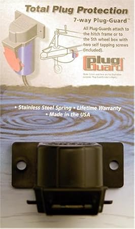

  • We use one of these:
    It mounts on the tongue and the plug goes up inside it to keep it out of the weather.
