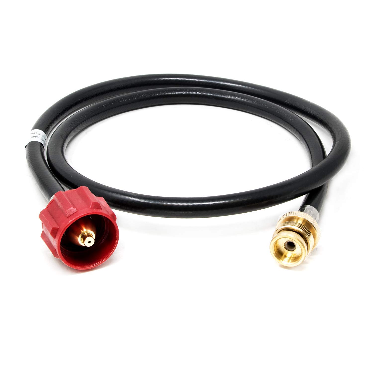

Your preference is fine, but there is an alternative hose for your grills and smokers to easily use the larger bottles without having to convert anything.
Propane tank hose to grill made for 1 pound bottles

Mike - punomaticExplorerI think Bobbo has the right answer.
