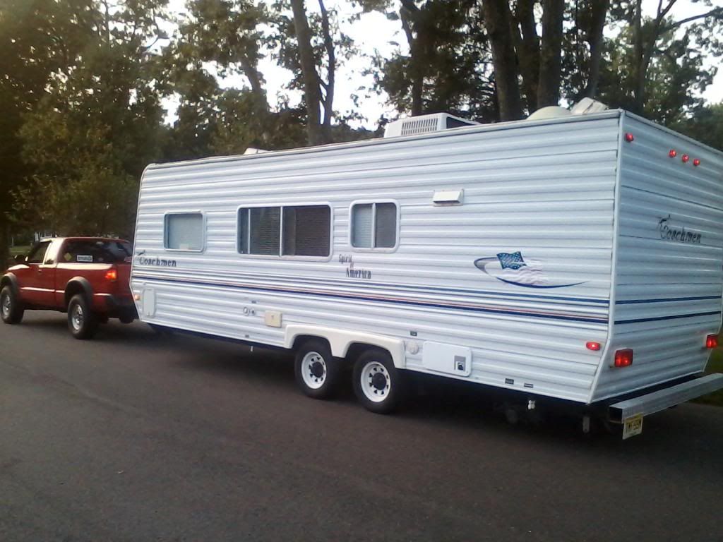

Chevy 1996 zr2 s10 towing 4135 lb dry camper
Well I bought the camper and am towing it with my s10.. I am worried about the weights and feel I need to take it to a scale to be sure of what I am dealing with.
I do scrap metal at times and can only tell you all the weight of the TV with myself and my 5 yr old with a half tank of gas.. This is at a scale where they weigh you coming in and then out after I unload the scrap metal I may have.
TV GVWR 4900
Payload 765 ( says on door sticker)
axle front and rear 2700.
GVW of TV from scale 4320 with myself and son.. about 250 lbs
I tried to go on the scale with just the front wheels to try to get a weight and do not know how accurate it was but I got 2560 lbs. ( May be irrelevant)
The truck has 3:73 rear and I have WD hitch. I set it up so I restored the height of the front to original. ( They say not to add more to the front. These are 1000 lbs bars.)
This truck has the 4.3 v6 with 190 hp and 235 torque at 2800 rpms.
I put the biggest trans cooler I could fit. A 20k GVW model. I towed once so far about 100 miles and temps never reached 180f at the trans. The gauge is installed after the rad cooler but before the added trans cooler. ( was just more convienent to do it this way)
Could not really fine tow ratings for the truck but what I could shows 5500 lbs in my estimite..
This is how its set by the pics. Any advice or am I doing OK?
Truck pulls fine, handles fine...ect.. Am able to use overdrive on the straights to save gas, otherwise I am doing 2500 rpm in 3rd. Gas guzzler for sure...Converter locks at 35 mph...
Thanks for any advice...

  • lawrosa wrote:
    Yes I had it too high in that pic.. I did drop it down a bolt hole..That was my first hook up, and I took it around the block looking for flat ground.
    My driveway was not level and I could not tell if the trailer was level....
    Good eye... You know what your looking at if you caught that...
    Thanks! Yes i pay close attention to little details like that. It seems as though you are happy with it. Just take it out a little at a time and keep getting used to it. Eentually you'll start venturing farther away from home!
  • Yes I had it too high in that pic.. I did drop it down a bolt hole..That was my first hook up, and I took it around the block looking for flat ground.
  • I think you`ll be OK. Maybe over on GVWR of the TV, but not extreme. The big thing is don`t go over the axle weights. The only thing I would add on your setup, unless it is just the way the pic is taken, is too drop the hitch head down one set of bolt holes! to get the trailer nose a bit lower, it looks nose high in the pics!
    Good luck. how does it handle right now? if it is OK then I would leave well enough alone and enjoy!

  • That sure looks like an awful large travel trailer for that midsize pickup truck.
    As long as you:
    1. Don't exceed axle or tire ratings.
    2. Are happy with the performance.
    Camp on!
  • Just figured out how to post the pics....LOL
    This picture makes the truck look small... Ha ha...
    Moderator edit to re-size picture to forum limit of 640px maximum width.
