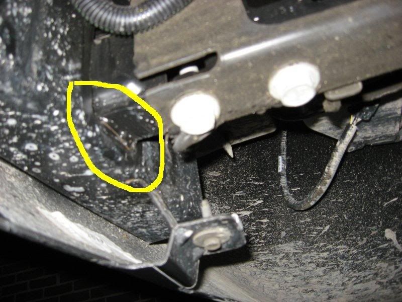

- a-d-sExplorerThanks for all the responses, you guys are thorough! I posted some photos below. Even though mine is a 2008 I can't see much difference between mine and Burbman's broken one.

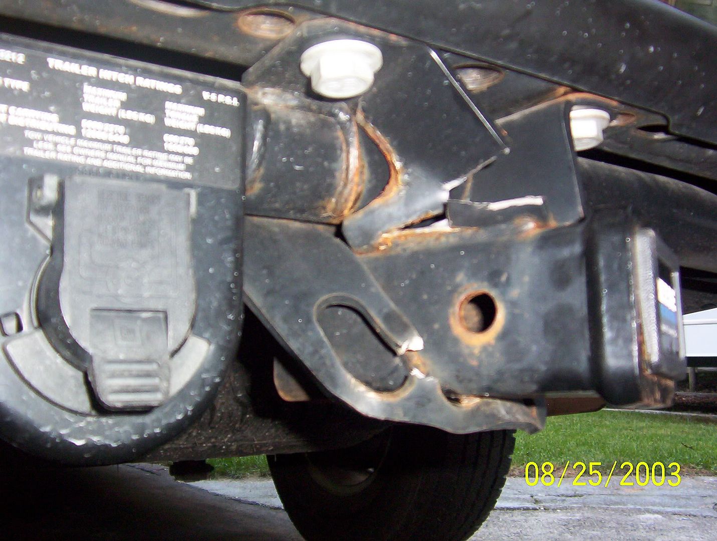

This is the GMT800 and the first to report it was Burbman

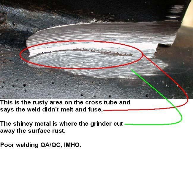

This thread shows a member who 'thought' he'd reweld it and during his
prep of grinding it down to bare metal found this...where the OEM weld
did NOT penetrate (fuse the two parts together)
New body style Chevy hitch questions. w/pics...GMT800
Notice the void between the two parts that should have been fused
together. Invisible and that for those who say they 'will keep an eye
on it'...

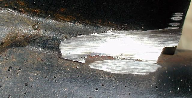

This is the same spot, but with more ground away
This is my analysis back then and still think so. Why 'keeping an eye'
on it won't see the water/rust damage until it is too late...

- BurbManExplorer IIIIf the OP's receiver looks just like the one in the pic, I don't see what's different from the problem hitches going back to '00.
To the OP, how heavy is your trailer? The primary issue with this receiver is using a WD hitch with heavy 1000 lb+ tongue weights. The design allows the receiver tube to flex, eventually breaking the welds by repeated "tin-canning". One symptom of potential failure is the inability to level the rig with the WD hitch over time. In other words, the same number of links on the WD bars don't get the rig as level as they did when it was new. The reason is that the receiver is flexing, and absorbing some of the WD energy that is supposed to be sending weight fore and aft to level the rig.
Many have reported a more solid ride and less bounce after replacing the factory receiver with an aftermarket.
I would say inspect the entire assembly regularly for cracks and stress and be aware of how the rig levels with WD applied. Alternatively, as Barney notes, you can replace the whole thing fairly inexpensively and be done with it. - APTExplorerThe infamously bad one was on GMT800 pickups and SUV, 2000-2007 "Classic" pickups. 2007.5+ are solid as I have never read of a failure.
