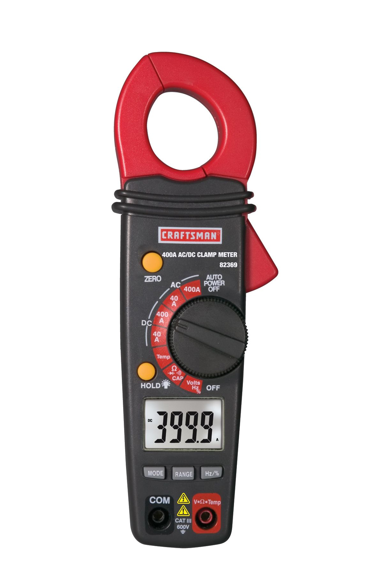

My 220Ah to 440Ah capacity battery banks will do me just fine using 2AWG and 4AWG size cables using my 60A DC Current PD9260C converter/charger for charging batteries. Using my clamp-on Sears AMPMETER I usually see DC current around 52-55AMPS of DC Current being pulled at the 14.4VDC DC Voltage charging modes... I also use this clamp-on AMPMETER to see the equal balance of DC Current going to the multiple battery connections when I am in charging mode. Great test meter to have around my battery banks...
