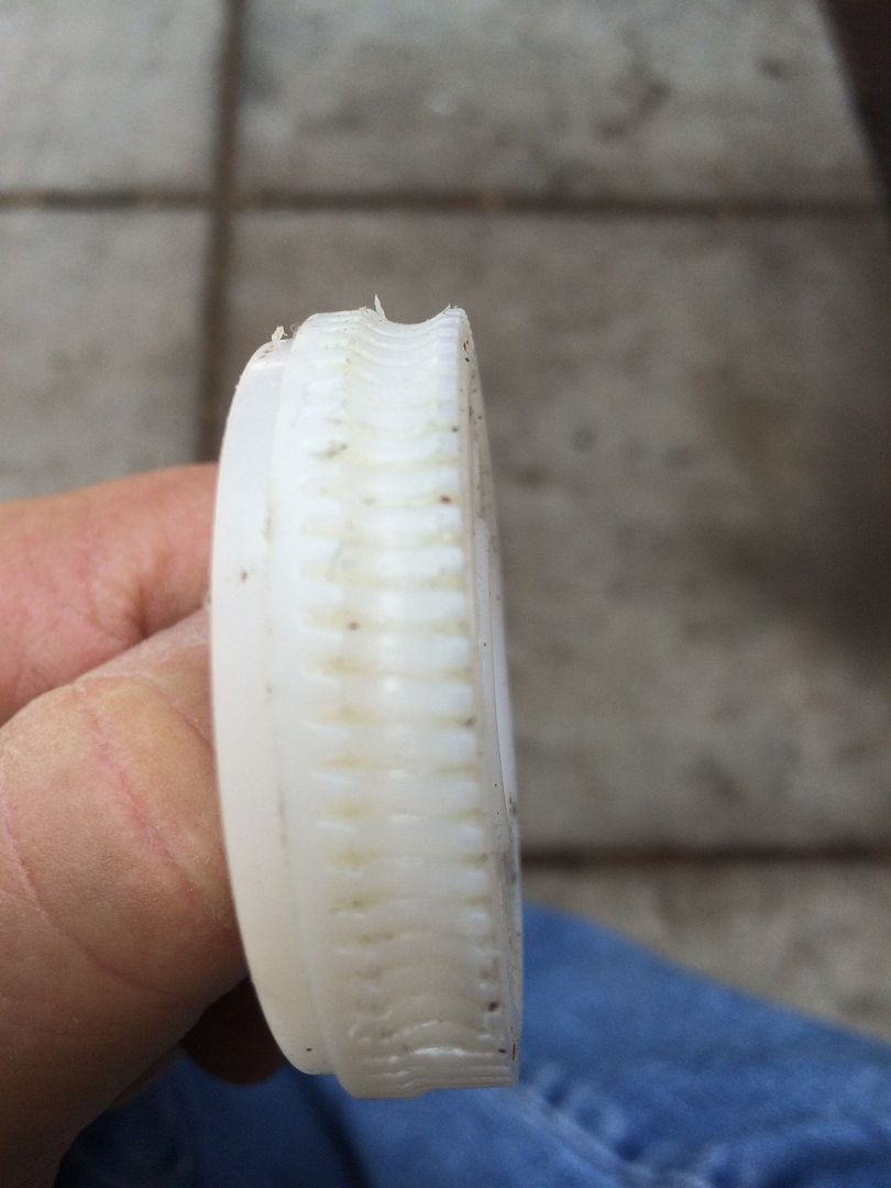

  • Disassembled motor and found this. Slowly eating itself away, metal worm gear and nylon gear configuration.
    Thanks Chris.
  • It pretty much does either work or not- the only way I know if to test the box is with everything else working correctly- the motor does have to draw enough current to shut it off. I have seen this part go bad- the part between the plastic shock absorbers and the gear, where I could just twist the gear without the motor running.

  • If it keeps running, something is broken. The control box shuts the motor off when the current draw gets high- but the motor must stall out at the end of travel for the current to rise enough.
