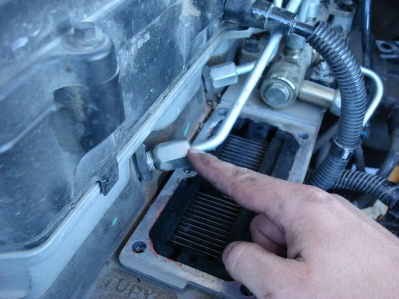

    Cummins uses 'grid heaters' on their motors
    My 5.9L has them and so does your 6.7L
    This is the grid heater on a 6.7L---finger is pointing to #1 fuel---grid heater is just below hand in intake manifold where air horn connects
