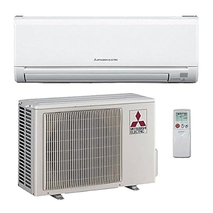

I am about as confused as anyone can get. The little research I have done shows a split unit. If so, where are you going to put the condenser?
They look like this
The condenser/compressor are typically mounted on the tongue, either above or behind the propane tanks. I also could be mounted on the back.
Running the 2 refrigerant pipes is the challenge.
If you have a strong back wall, they make brackets so you can mount it directly to the wall. - Charlie_D_ExplorerI am about as confused as anyone can get. The little research I have done shows a split unit. If so, where are you going to put the condenser?
