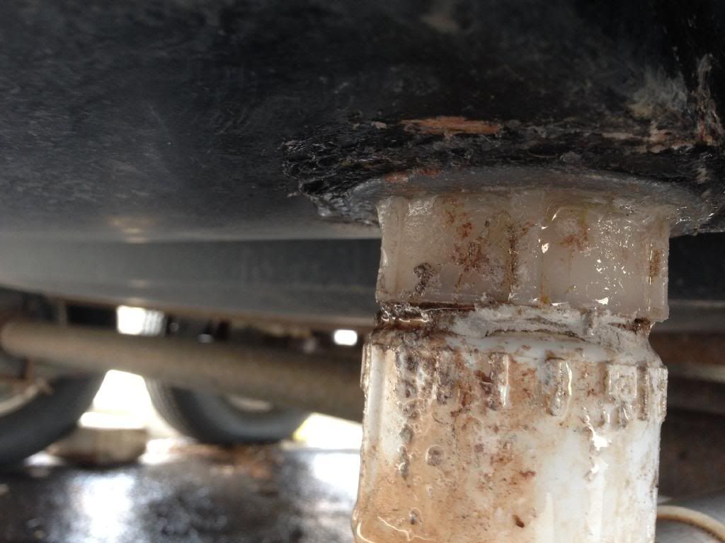

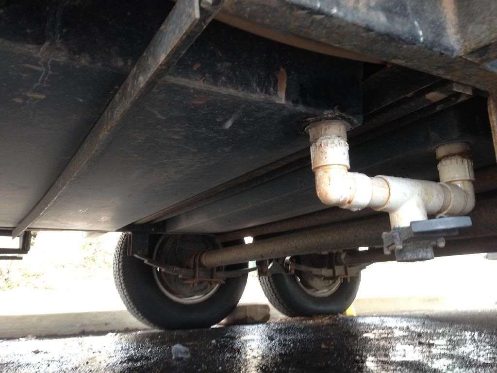

  • I just went out this morning and took another look at it, measurements, and pictures. It looks like it's a 2 inch pipe coming out of the bottom of the tanks.
    View of Both Tanks and how they are connected:
    Closeup view of the connection coming from one of the tanks, it's leaking from where the upper part of the white pipes meets the tank. So does it look possible to replace, or what's the best way to seal it? I'm not certain, but it looks like the bottom of the tank might be threaded, and that I might be able to cut off the T and unscrew the lower threaded connection from both tanks, remove upper from tank and re-seal, then put/glue back together.. Does anybody know whether the tank itself is threaded?

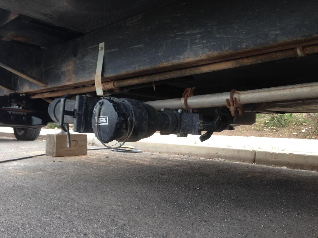

    And just as a reference, this is the Black and Grey tanks more towards the front of the trailer:

  • Hmm, that sure sounds like a waste water tank you are talking about. Never seen a fresh tank with a 2" outlet to a gate valve.
  • Thanks! Yep, definitely 2 tanks. From what I can find, it's suppose to have a 110 Gallon fresh water capacity, split between 2 tanks. The good side of it, they are mounted on the bottom of the frame, no insulation or anything in the way. It's just dripping onto the ground. Tomorrow I'll wipe the area down and see exactly where it's coming from.
    So, by readily available. Do you mean available at the local hardware store, or do I have to go to a trailer/camping supply? They look like standard 1.5-2 inch PVC pipes coming off the tanks.

    Its extremely uncommon to have two fresh water tanks. Are you certain that indeed you do? The tank fittings should be readily available if indeed it is a faulty fitting, the biggest issue might be getting access to replace them. Do you have insulation or plastic covering on the bottom of the trailer covering the tanks. By removing part or all of it in the vicinity of the tank and putting in a few gallons you should be able to find exactly where the leak is without more water ending up soaking insulation etc. Hopefully someone with a similar model or water setup comes along to help troubleshoot.
