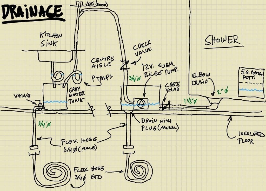

Gray water drainage design help (see drawing)
Hi everyone,
I'm working on my very first DIY camper conversion, using a 2010 extended Ford E250.
I'm trying to plan out my gray water sewage system, I want to keep everything above the floor in the heated area. I want to have these options :
A : gray water holding tank
B : flexible hose from my camper to camping site sewers
C : directly to the outside ground
As you can see in my floor plan, my biggest problem is that I have the center aisle between the shower and the kitchen sink...
I thought of using a small automatic 12v bilge pump to pump the shower's gray water over the center aisle into the holding tank under the kitchen sink. The specs for the bilge pump : 750gph, 12volt, 3amp draw, 3/4" outlet, 28$.
When I decide not to use the gray water tank and dump the water outside (either in the sewer or on the ground) I simply remove the plug from the drain inside the pump's temporary tank, the water is drained directly outside so the pump never comes on.
Please let me know what you think or any advice what so ever, I have no experience, I'm only using my logic.
