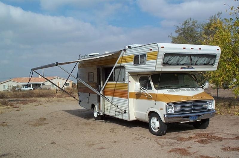

    In your case your description of your CLASS C is vague in addition to your battery bank description. Most of us understand AH ratings not MA rating... I'm think your class C is 15-foot or so in length. Might look something like this...
