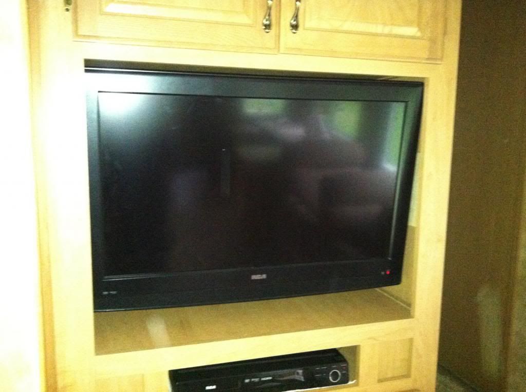

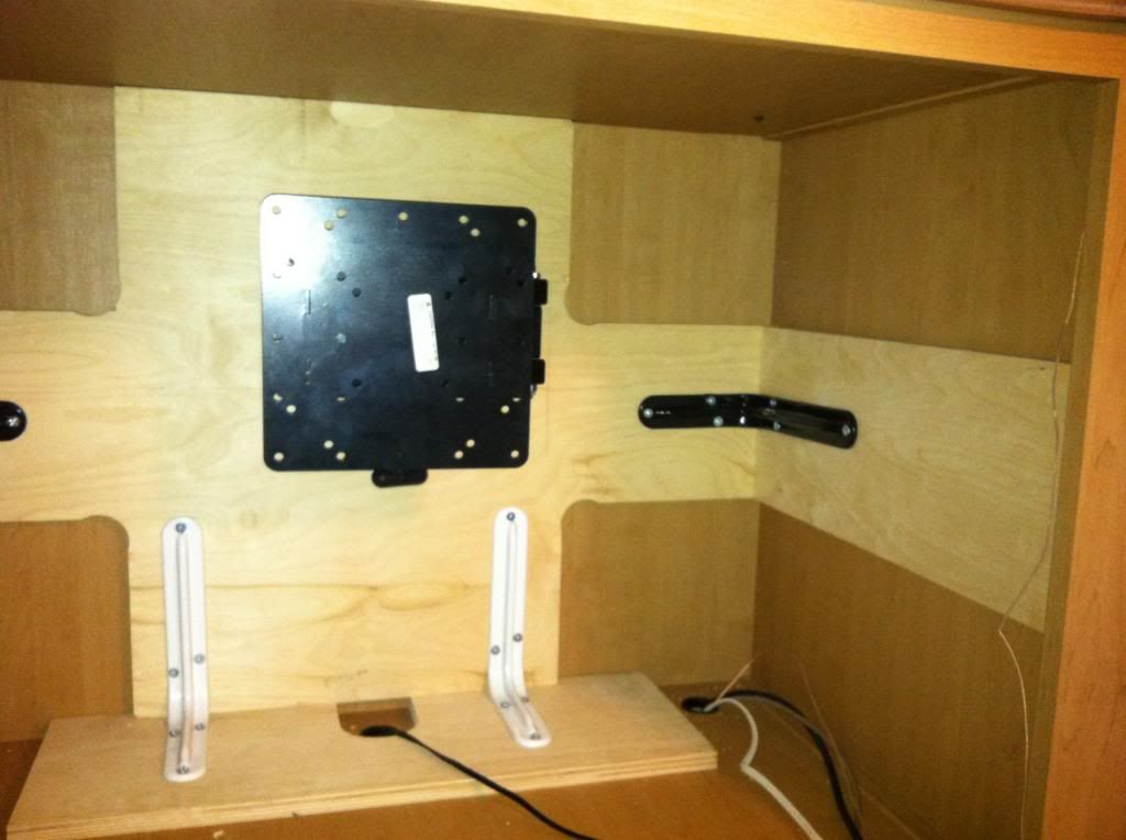

Installed a television mount without any drilling into rv
Finally got the rig out of the barn and installed my television wall mount. I didn't want to drill any holes through the cabinet wall in hopes of finding an anchor point so I came up with an idea shown in the photo. The back plywood piece is cut to fit very tight in the cabinet frame and so are the rest of the pieces you see. So the whole unit is held in place by virtue of a partial "box" built inside of another box for lack of a better way to explain it. With the TV installed and pulled out towards the front, you don't see any of the woodwork. Hope this might help someone out!
