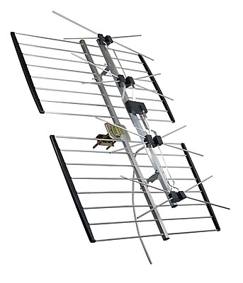

I also experimented with the dual BOW TIE antenna array and this outperformed both the BATWING and the JACK antenna. But I am sure this antenna life expectancy would be very short having to take it up and down alot and packing up for transport in my case...
Google image...
This antenna array with an added PREAMPLIFIER at the base of the antenna is what I use now here at my house for ANTENNA TV reception. I can move the two bays like shown and makes it broad beamed enough to pick the spread of transmitting antennas in the Washington DC locations. Great reception here at the house for ANTENNA TV...
