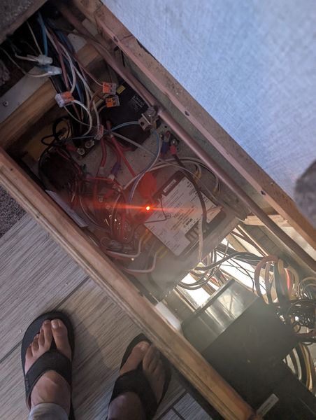

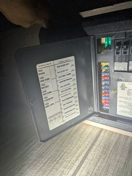

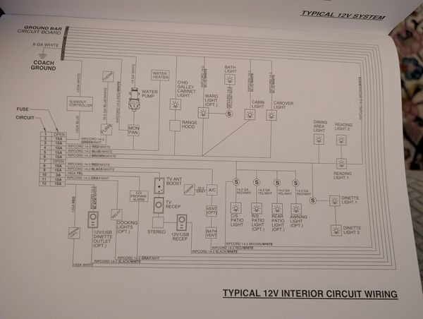

I looked up the wiring diagram (attached) and they all seem to come from the same circuit. I traced it to the distribution panel but all the fuses appear to be good. I put a multimeter on each fuse on the continuous ohm setting and I get a beep on all of them. Is there another fuse I should be checking that I don't know about?

      All the ground bars looked good. Everything was tight.
      Pulled the 15A fuse again to inspect it and it looked fine so I put it back.
      Checked the blue/white cable that's called out in the manual and tightened the wire nut for it. One of those two things did the trick.

        Probably the wire nut. Wire nuts are a poor choice in mobile applications. Might want to substitute crimp connectors that won't vibrate loose.
