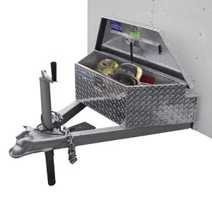

Try TorkLift Power ArmorTorklift
Thank you Bill&Kate, Cool looking functionality. Like I thought it is more trailer oriented that MoHo oriented.
Google "trailer tongue storage box." They have angled sides that match the A-frame angle in a TT. Available in different dimensions and steel, plastic or aluminum. Can sit on top of the A-frame or between the A-frame tubing. I think these look nicer than a square storage box.opnspaces wrote:
