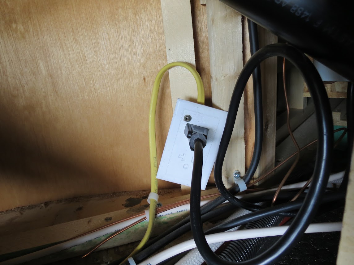

When I was inside the panel I noticed a black cube about an inch on each side on the back of the panel with some (looks like 12ga) wires coming out. I looked up WF8930/50 and discovered that it's a 20A receptacle pointing backwards (i.e. only accessible from behind the panel).
It's not hooked up to a breaker so I'm wondering what it's for. I'm guessing that in another configuration, that plug might be for a converter. What do you think?
BTW, the wire that goes off to the installed converter (100A) is clearly 14ga. The breaker is 20A - is 14ga enough for that?

    Joe - I had to add one of those 120VAC receptacles for my setup... The WF8900 series converter was direct wired to the breakers and the replacement PD9200 series converter came with a 120VAC plug.
    As long as it is the actual wire off the appliance it is fine. If you need to extend the wire use #12.
    It runs to a 20A receptacle where the plug from the converter, well, plugs.
