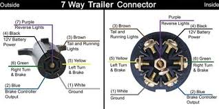

OK I just bought a 2008 Lance 830 camper. Everything except the running lights work fine. So I accessed the battery box where the leads from the plug come in and thought I could just check for continuity by putting one lead on the correct terminal on the plug and then check each wire back at the battery box until I got continuity, but all the wires at the battery box show continuity except the power lead. This is the case for the other terminals on the plug.
So much for my basic electricity skills. I did check my truck and the marker terminal is producing power, so I know the truck is good.
Anyone know which color lead is the one for the marker lights, and if there's perhaps a fuse somewhere on board that I should check? Also wondering if there is a better way I should be troubleshooting this.
