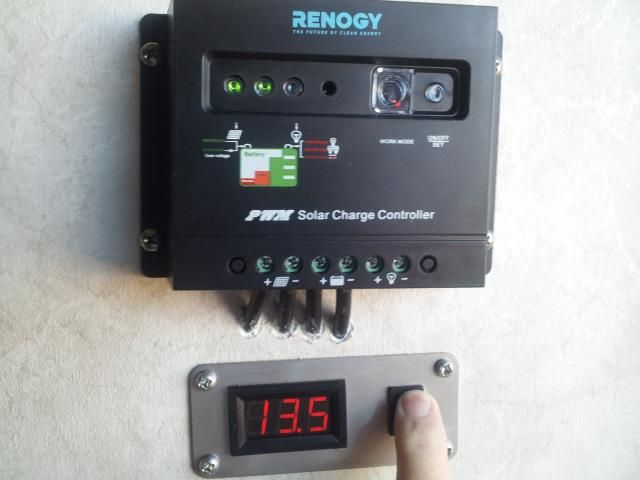

Just received my kit. 2 100w panels with a 30a pwm controller. Hoping it will recharge my 2 GC2's. I am alone in the trailer and power use is min. Any thoughts?

Your connection sequence is batteries to controller then array to controller. So you don't want to disconnect from batts with the array still on the controller. Covering the panel would be a good way to switch off solar. I put a switch on one of the wires from the panel close to the controller but my controller is easy to get at for that.
Useful if you are disconnecting the batteries for various reasons, you can turn off the solar first on the array side. Also with the array wire "open" you can measure Isc and Voc if you like.

You don't have to run the batts down. Just put a load on them higher than what the solar could do and then connect solar and note the difference.

Isc = 5.92
Irradiation on a flat panel local solar noon ~ 800 (feb, AZ)
http://www.nrel.gov/midc/ua_oasis/
Panel output in amps, 2 x 6 (Isc) x .8 = 9.6A
Likely better when new.
NinerBikes wrote:
Maybe get us volts and amps tommorrow at 10 or 11 AM when the batteries are a bit lower state of charge. Want to see what kind of amps 200 watts is putting out.
