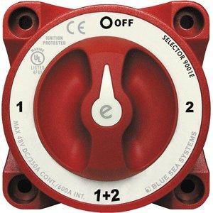

Always plan on using the BLUE SEA type BATTERY switches for this type of setup. It is sometimes necessary to isolate your two battery banks and charge one bank at a time...
I have used this brand of battery switches in my working years on many DC systems..
