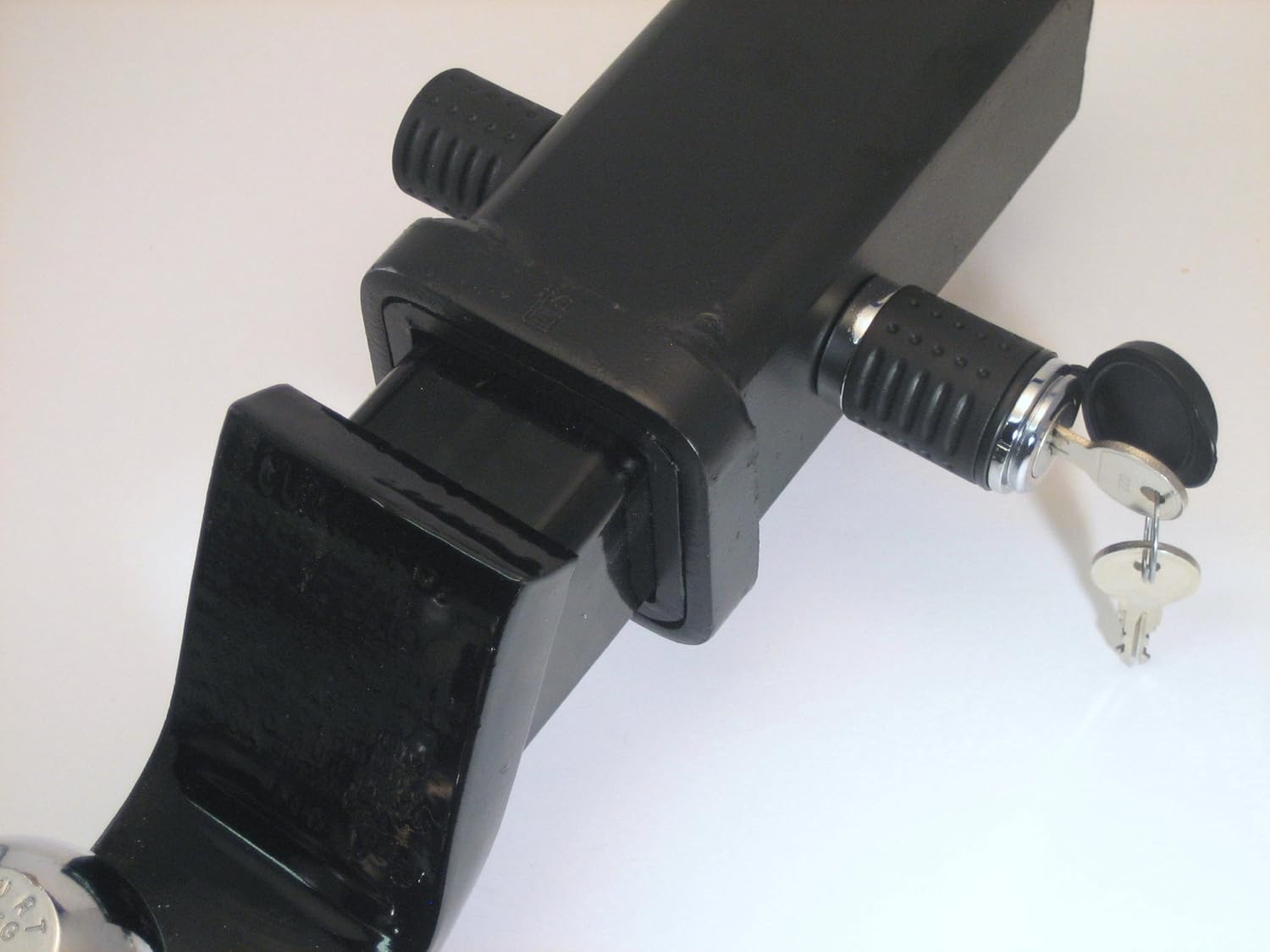

I had an old ball mount my son had found in an old pickup that he had obtained (and since discarded!). It was a 6" drop mount, and we have nothing that we'd have used it on. Additionally, it was pretty tattered, and an off brand that didn't seem that sturdy. This, and the original u-frame from the roller that I'd purchased from CW for the first roller project came together this weekend as this:

The previous owner of the unit had put a set of casters such as these on the unit; one was bent and had lost most of the ball bearings in the caster:
It didn't take me long to remove those.
