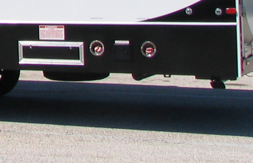

  • My tanks have tabs welded to their bottoms. Those tabs are bolted to cross-members.
    This is a photo of my fuel station and filling points. None of the associated pipes go through the frame - they go under it.
    The fill points are so low they just go in the top of the tanks. Makes it hard to fill them - have to go slow!
