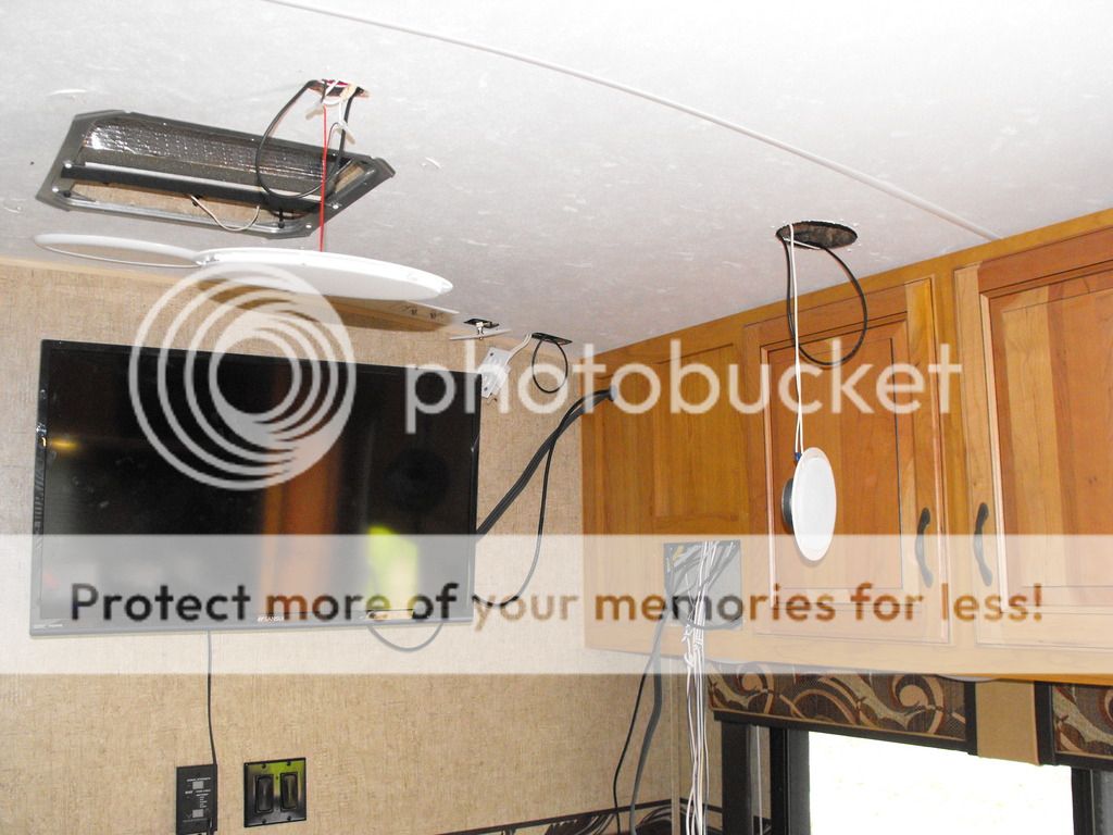

I've run plenty of wiring through the ceiling space in 3 TTs - co-ax, HDMI, #14 to #10 romex and low voltage wiring and from one end to the other of the trailers. Never been stuck and not able to do it. A small area above a bed should be easy peasy. Photo below shows a project of mine in progress. My approach is any mods I do must look like they were factory done.
