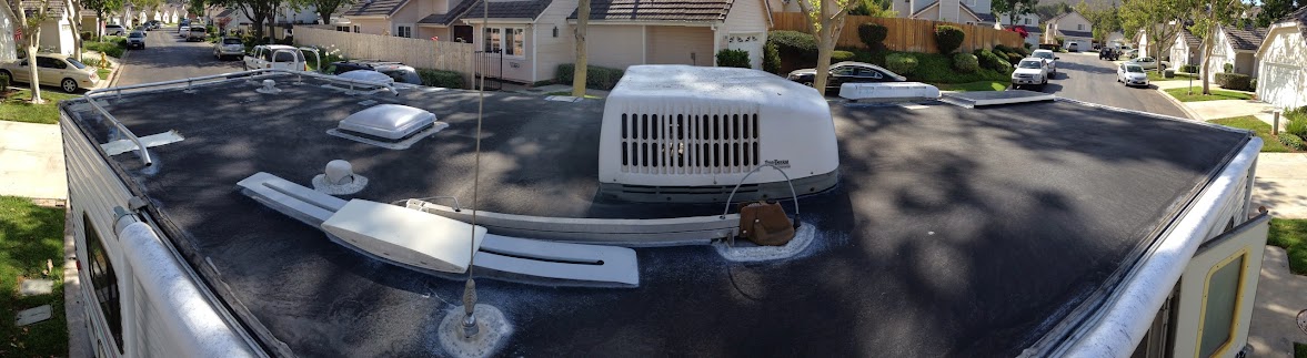

Here's the roof right before I started digging in. The rubber was so thin that I was finding tears caused by chassis flex after every trip.

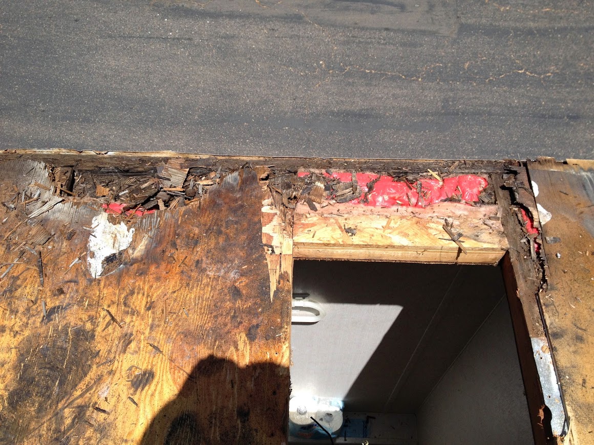

Not surprisingly, I found rot at the two aft corners of the coach. Aside from about two two-foot by two-foot sections of rot in the corners and some previously repaired sections of the roof, the rest of the framing was in great condition. Additionally, the rot did not travel down into the walls! Winner!
Driver's side aft corner.
Passenger's side aft corner:

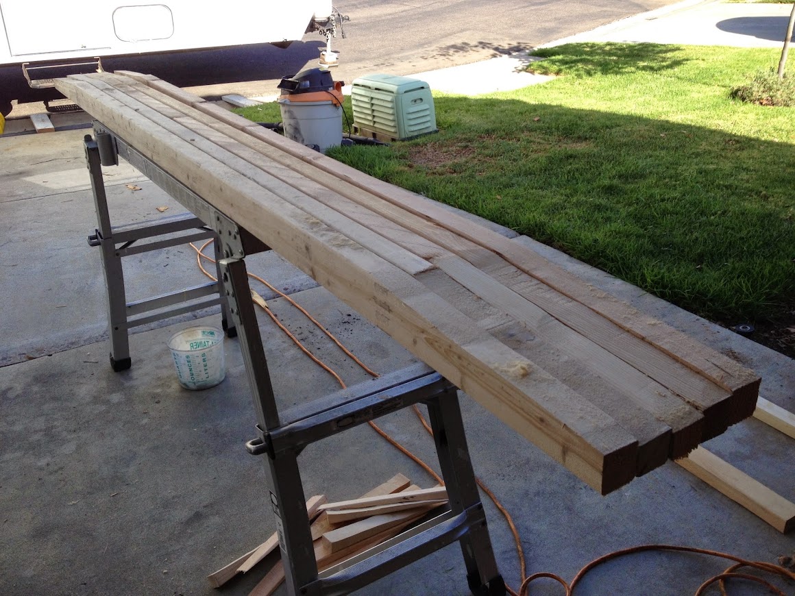

I closed out the day by making some new rafters to reinforce the saggy roof. Don't worry, I sanded the rafters to match after I took this photo.
