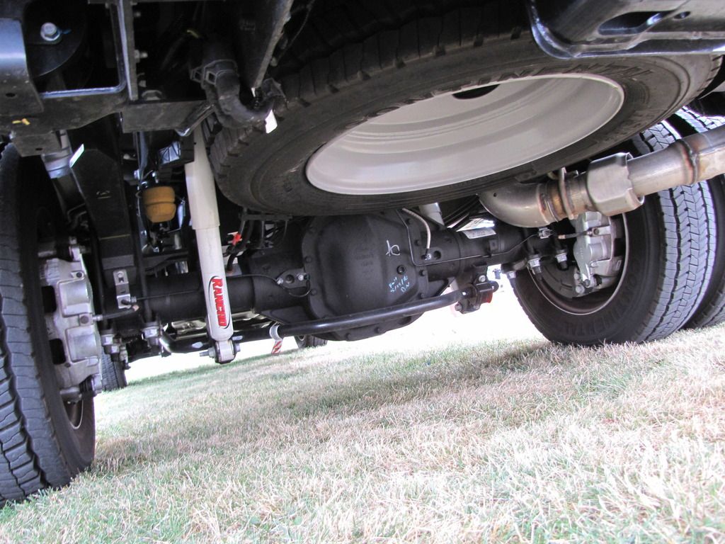

Troy,
What rear axle is that? Obviously it's not the same as the 2016 F450. It looks big, but not as big as the previous model. Maybe a way to shave some weight from the truck as the S130 was probably a bit overkill for the pickups.
Rich
Rich, the new DRW axle that replaced the Dana 80, 110 and 130 is the Dana M300. The 350 DRW will also use it.
There will be 2 versions. A light duty and a heavy duty version. The 350 DRW pickups and C&C trucks will use the light duty version and the 450 pickups and 450/550 C&C trucks will use the heavy duty version.
The new SRW axle added to the lineup is the Dana M275. It will be in diesel equipped 350 SRW trucks along with diesel 250s with the High Capacity tow package.

I'm going to guess that means a 275mm ring gear or 10.83 inches. Slightly upsized from the Sterling 10.5 if my guess is correct.
And 300mm equals 11.811 inches. Edged out RAM by 0.011 inches.
(Sarcasm on) There is another bragging point to write home about.
