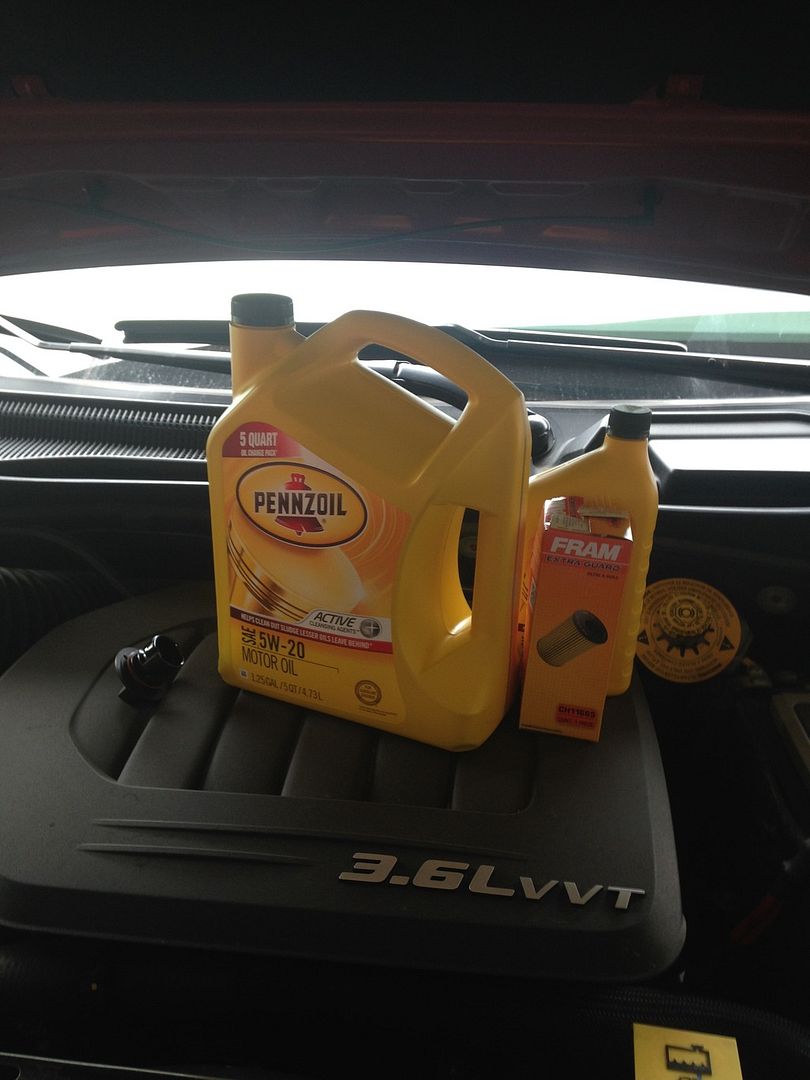

With that said. I picked up 6 quarts of Pennzoil conventional (PYB, Pennzoil Yellow Bottle) to replace the Amsoil OE and a new Fram Oil Filter (gasp, but they make a darn good cartridge filter) today. Chrysler lets this oil go 8-10k miles before the OLM goes off so I am not afraid to run this.
I double checked my log and its been 7,060 miles since the last oil change. So the oil wasn't as "used" as I thought. No worries, I like refreshing oil sub 10k anyway.
So, here is a shot of the PYB Oil and the filter.

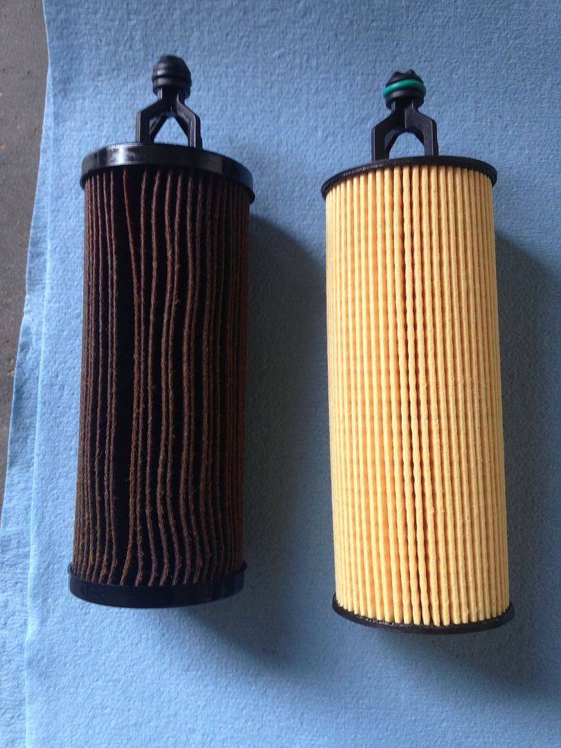

I used a Wix oil filter with the Amsoil OE... Here it is laid side by side with the Fram. Perception is skewed a bit as the Fram looks longer in the picture.. it is not. The end caps on the Fram have no significant lip compared to the Wix. I am not afraid of the element moving as the end caps are connected by a plastic cage that travels down the center of the filter.
Something that surprised me is that there are many more pleats in the Fram Filter than the Wix. I know the wix is used but it had those distortions in the pleats when I first bought it. Interestingly.. the Fram should have more surface area to filter the oil.
