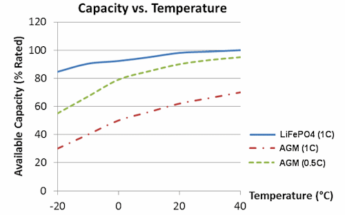

Yes, I have used my lithium pack in low temperatures discharge down to about -15C and charging at ~ -10C. The voltage was definitely lower at low temperatures, and I assume they loose some capacity (I have plenty to spare, so I have not tested this). The loss of capacity with temperature is true of all batteries, and is actually less severe with LiFePO4 vs AGM/FLA:

Did a cursory look for a graph that shows the maximum charge (and discharge) current and temperature relationship for LifePo4, but couldn't find one. Have you seen one? - Grit_dogNavigator IIInteresting. I thought the loss of capacity was similar to the charging loss and not better than lead acid. That’s encouraging

Yes, I have used my lithium pack in low temperatures discharge down to about -15C and charging at ~ -10C. The voltage was definitely lower at low temperatures, and I assume they loose some capacity (I have plenty to spare, so I have not tested this). The loss of capacity with temperature is true of all batteries, and is actually less severe with LiFePO4 vs AGM/FLA: - jaycocreekExplorer II
