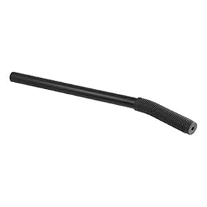

- wanderingbobExplorer IIHook up the WDH before lowering the trailer onto the bar .Once ya do it a few times it is easy . As for pipe , a one inch EMT conduit works fine , buy a ten foot piece at lowes for a couple bucks and make five of them .
- sgfryeExplorerI bought a spare off amazon about 10 bucks

X2 - LJAZExplorerGo to your local big box hardware store and pick up an 18" or 24" piece of black iron pipe. Only costs a few $$,
Something like this:
https://www.lowes.com/pd/Southland-Pipe-1-2-in-x-1-1-2-ft-150-PSI-Black-Iron-Pipe/1000227939 - HuntindogExplorer

- ScottGNomadJust a 1' iron water pipe would work fine. Pick the length of your choice.
I carry an extra pipe that's about 4" longer than the supplied handle. Works great when I need extra leverage. - downtheroadExplorer
