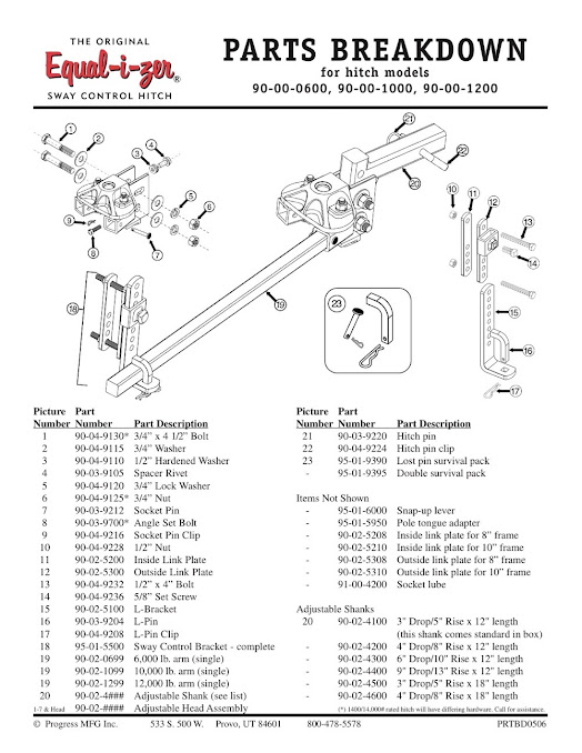

  • Here is the older Equal-i-zer parts breakdown.
    Here is the newer Equal-i-zer parts breakdown.

    Unfortunately you haven't provided any specific details about your particular version of Equal-i-zer nor how old it may be. That's important because Progress changed the design of the frame saddle bracket assembly (specifically the outside link plate) several years ago because of the problem you're describing. The original L-bracket was part #90-02-5100, the redesigned L-bracket is part #90-02-5150, with the outer link plates also having different numbers. If yours is the original it wouldn't be surprising that it bent ... post a pic so we can first identify just which version you have. Otherwise, call Progress Mfg, provide the serial number of your Equal-i-zer, describe the problem and they're sure to have a solution for you.
