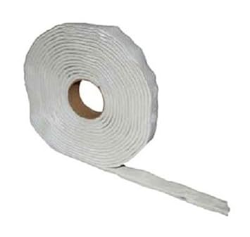

    The neat thing about this kit is instead of using silicone or putty, they supply a VERY sticky/soft two face tape. Regular two sided foam tape that you buy in the office supply store will not work as it is too stiff and won't act as a sealant like this supplied soft tape does.
    The OEM install used this same type tape, they did not use silicone or the gray putty.

  • Just noticed a crack in the plastic frame around the top window on our door so will be replacing that in next couple days. The bottom one had recently been redone so just one here. Local camper place keeps them in stock. Have thought about new door but have to keep checking since its the old square version and a bit harder to find. Love that butyl or putty tape for all kinds of sealing fixes. Keep a spare roll in the fridge all the time. Sticky mess if it gets too hot left out laying flat. In the fridge it stays useable forever.
