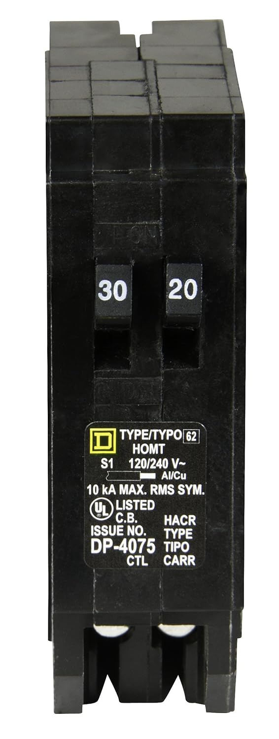

- GordonThreeExplorerI ordered a 30/20 and a 20/15 from home depot's website. It was free next-day ship to store, but not available from the store itself. Square-D HOMT type.
- myredracerExplorer IIThe required tandem style breaker is readily available everywhere. Different brands are interchangeable. For example, our WFCO has factory Square D and Seimens breakers that I added. The face of a breaker has the series/type of breaker it is - HOMT, Q, QO, etc. The amp rating for a tandem breaker would be "3020". If you aren't sure what to order strictly by the correct numbers & letters only, the easiest thing to do is take it to a store and get them to match it. Or go to an electrical wholesaler. You *could* take a photo with your phone but the lettering is teeny weeny and barely readable to the naked eye. WFCO should have a list of breakers that can be used on their website.

Below is a Square D "HOMT3020" and Seimens "Q3020" tandem 30/20 amp breaker.

Roy Ken - BB_TXNomadYou may have to order one on line. I could not find a 15/20 breaker at Home Depot, Lowes, or large hardware store. Googled the model number on the side of the breaker, found numerous sources, and ordered one.
- Kayteg1Explorer IIYou should find them at HD. Pull one as sample, or take a picture on your phone.
Pay attention to the connector slots. Some looks the same at first look, but have cross slots and breaker without them will not fit.
