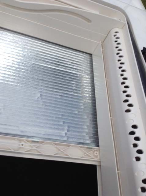

The issue was related to my Dometic Midi Heki skylight in the front cab-over area above the bed. For most of the summer I kept the shade pulled shut on the skylight to keep it from getting to hot inside the camper and I also like to sleep in so it helps keep it dark inside the camper.

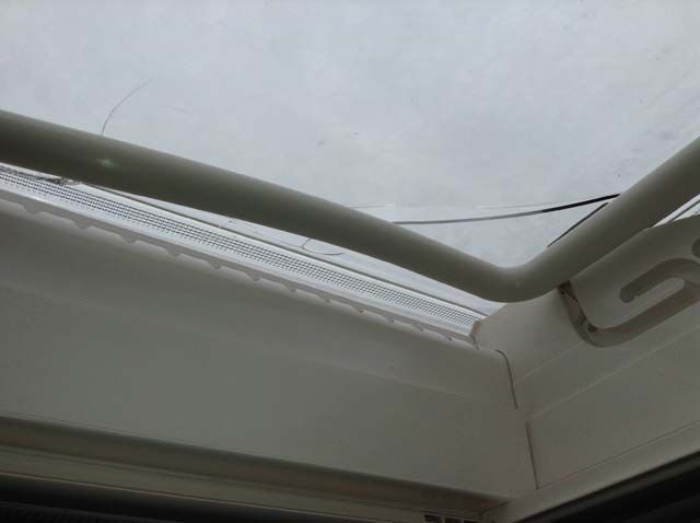

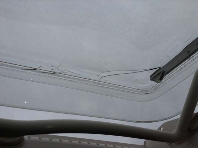

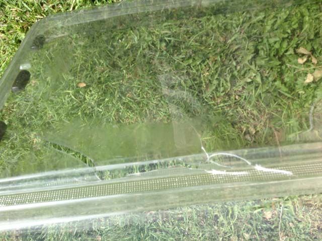

On a trip in early September I opened up the shade on the skylight to look at the stars at night. When I woke up in the morning I was looking up through the skylight and saw what looked like a crack. I sat up and on closer inspection sure enough it was cracked. I tried to imagine how and where it got damaged because I hardly ever touched the thing since it was new. Upon further inspection I determined that only the inner layer of plastic had fractured. The outer shell was completely intact which ruled out a rock or bird strike while traveling. Plus the damage was at the rear of the skylight and not the front.
As I was running my hand across the inner layer of plastic I noticed it was no longer flat and that it had a warped feel to it in an upward direction. I came to the conclusion that while parked in my back yard with the hatch facing directly into the sun it had became hot enough to warp the plastic.
How did it do this? Well after looking at the top of the shade I noticed it has an aluminized coating on it.
When parked in the sun with the shade closed and hatch shut this little area between the shade and the hatch glass becomes like a small oven in the upper 90-degree heat we had this summer. (I bet I could have cooked a loaf of bread in there.) As the plastic warped upwards and the hinge lever pulled downward at some point the stress was too much and it broke the hatch. The locking lever bar only pushes/pulls on the inside layer of plastic by the way.

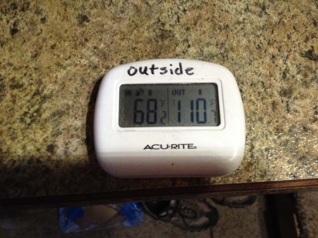

I wanted some actual numbers so I could show my dealer as well as Northern Lite what was going on so I did a test to see what the temperature was. By September we were past our high 90 temperatures but I set a remote thermometer probe on top of the skylight and watched what would happen.
The first picture shows an outside temperature of 68 degrees with a temperature of 110 inside the skylight. This was on a fairly overcast day up in the mountains on the day I discovered the crack.

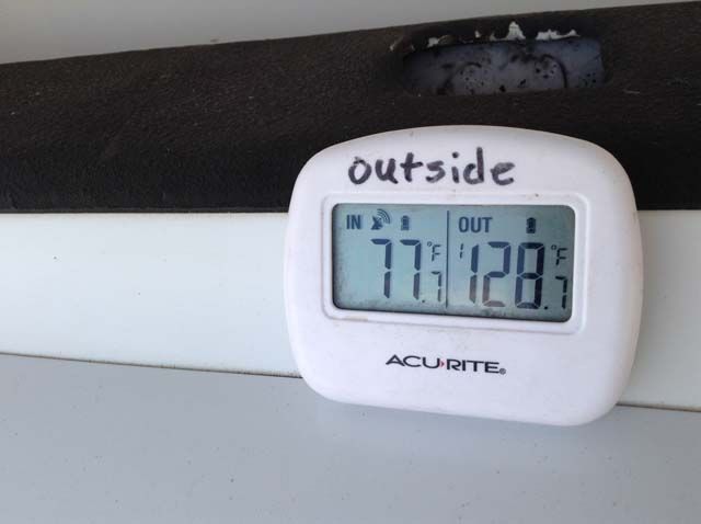

Later that week, at home in my back yard, I was able to test it with some outside temperatures in the mid 80’s.
The first picture shows an outside temp of 77 and it was already 128 inside the skylight. (disregard the in and out notations of the thermometer, the wireless probe is intended to be placed outside while the display unit is inside. The higher temp is inside the skylight and the lower temp is from outside in the shade sitting on my dually fender)

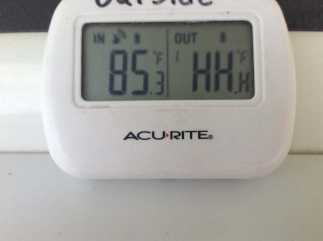

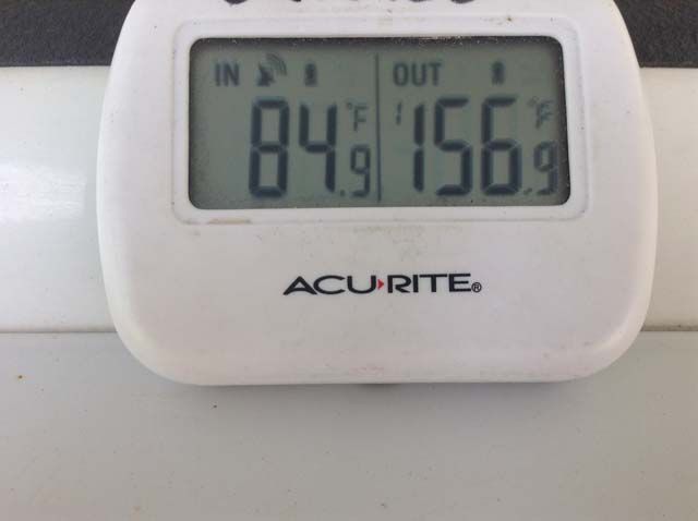

I let it sit for a few hours into the afternoon and recorded these readings.
The HH.H reading meant that the temperature inside the skylight exceeded the measuring capability of my thermometer but I am sure it was well above 160 degrees.
During the summer heat with the outside temperature nearing 100 degrees I could imagine the temperature inside the skylight with the aluminized shade pulled shut could get well above 200 degrees. It’s too bad that Dometic didn’t account for this and use a higher heat resistant plastic in their design. Surely they don’t expect people to leave the shade open in the heat of the summer sun, that defeats the whole purpose of having a shade! Maybe if they get enough warranty returns they’ll change the plastic.

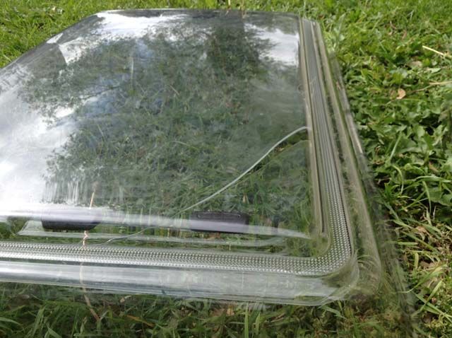

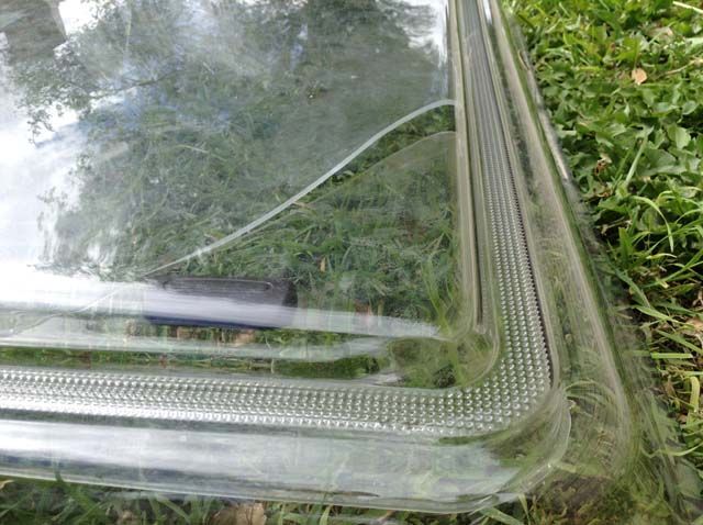

I was able to remove the part myself and take it to the dealer and trade them so I didn’t have to drive my camper all the way to town. Here are a few shots of the damage with it off the camper.
