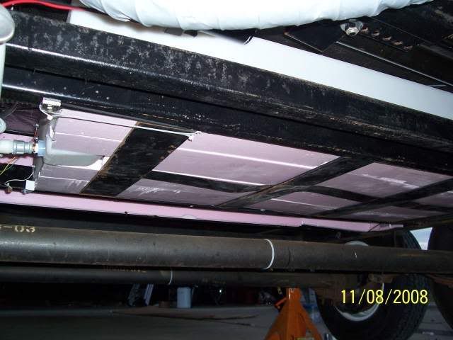

We have traveled long distances with the fresh tank full. Not always but often. Our camper came with a steel cage supporting the fresh tank. This may have been unique to Sunline, but I am glad they did.

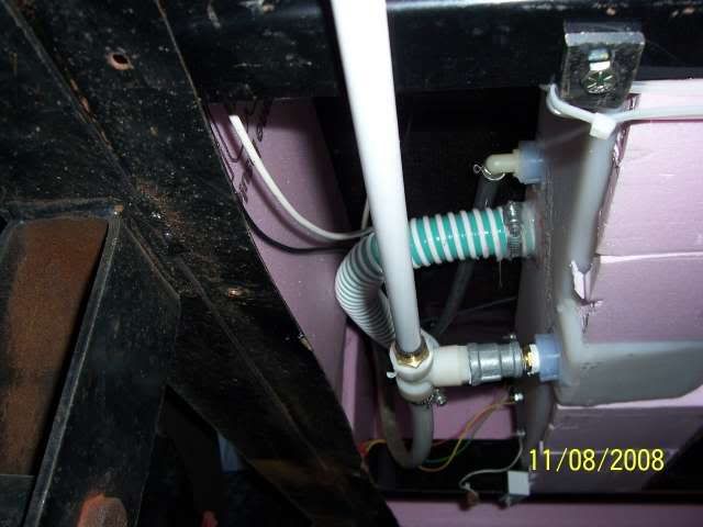

This is our current Sunline with an enclosed tank compartment. I also reworked the pump suction port from the side of the tank to be on the bottom. I can now draw the last quart out of the tank. This comes in real handy when bookdocking.
A few pics. Our current T-310SR with an enclosed tank compartment.

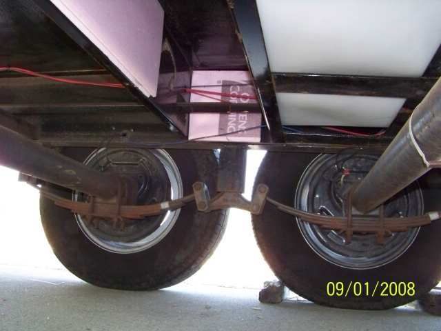

A partial pic, you can see the black metal frame under the white fresh tank. The fresh tank is right over the front axle. No change to TW.
The pump suction reworked. Both the drain and the suction port
A view of the bottom cage
Our prior Sunline, a T-2499. No enclosed tanks and the fresh tank was about half way between the front axle and the ball coupler. This added considerable TW. Added 200# to the TW. This cage frame setup is the same as our larger T-310SR just a better pic to see the frame. Also reworked the pump suction port to the bottom.
